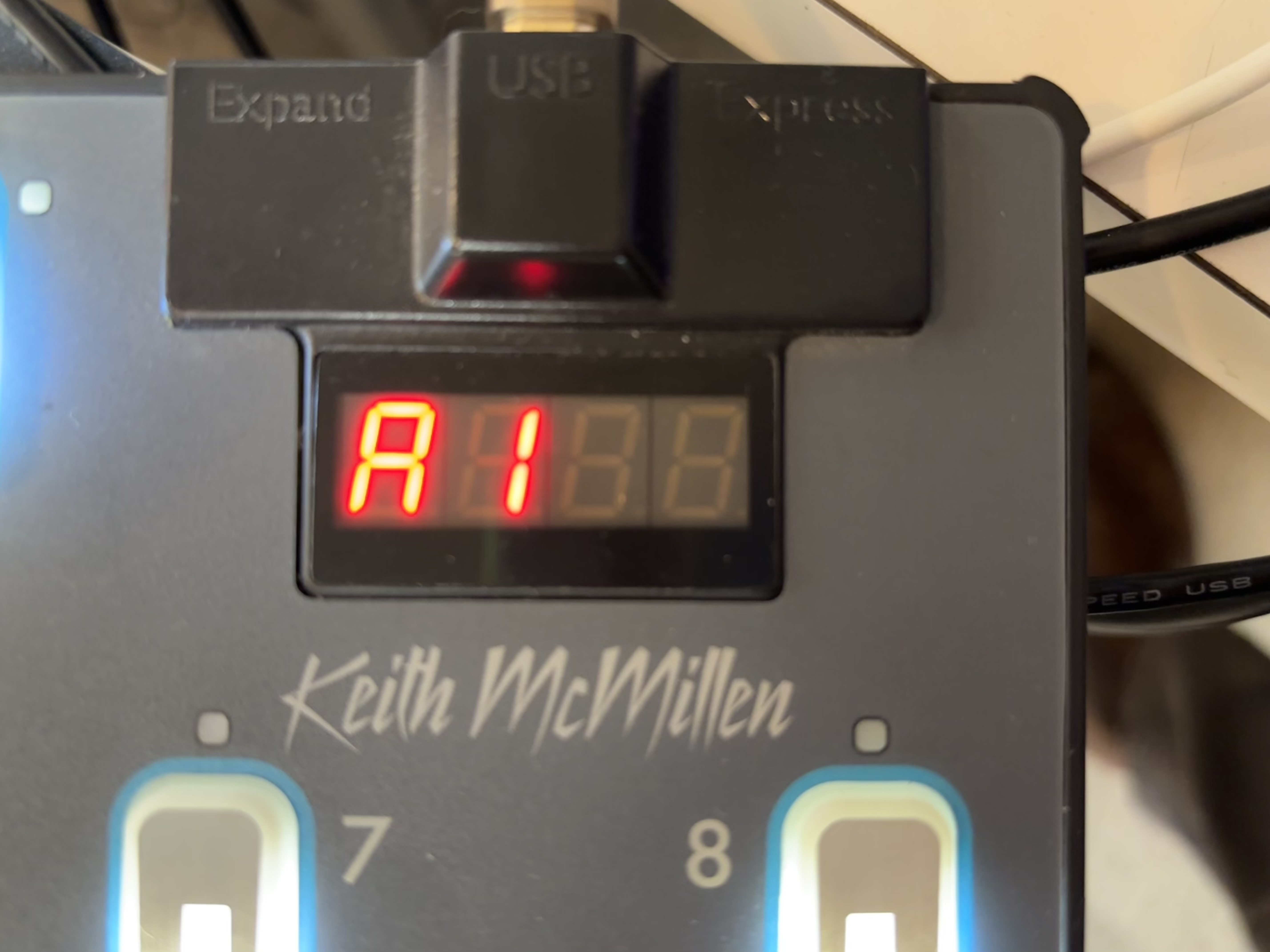

Upgrading From Firmware VA1/VA2/A1/A2
The USB Driver in Firmware A1/A2 is not compatible with modern MacOS and Windows computers. You will see the device listed in Device Manager and/or System Information, you might even see the USB MIDI Ports, but MIDI data (notes or SysEx) will not flow. This has caused some confusion with users who think that the latest editor has bricked their device, when the real problem is that the editor cannot communicate with the firmware.
To upgrade firmware VA1/VA2/A1/A2, you will need the following:
  • A computer running MacOS 10.12 Sierra or Windows XP/7.
  • Editor version 2.x (12 Step Legacy Download Link) running on the older operating system
  • A modern computer running the latest editor and the SendSysEx utility (optional)
You will need to use the 2.x editor to update the firmware to version 28. From there, you can either continue using the older editor with version 28, or you can move to a modern computer and use the SendSysEx utility (see above) to install a bootloader and update to version 1.x or later.
